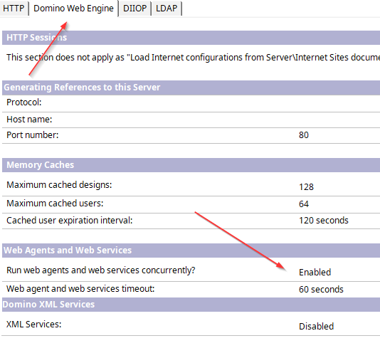

Remember to allow concurrent Web Agents in server document.
Otherwise Web agents are run sequentially, which is not what you want with 4000 users.
