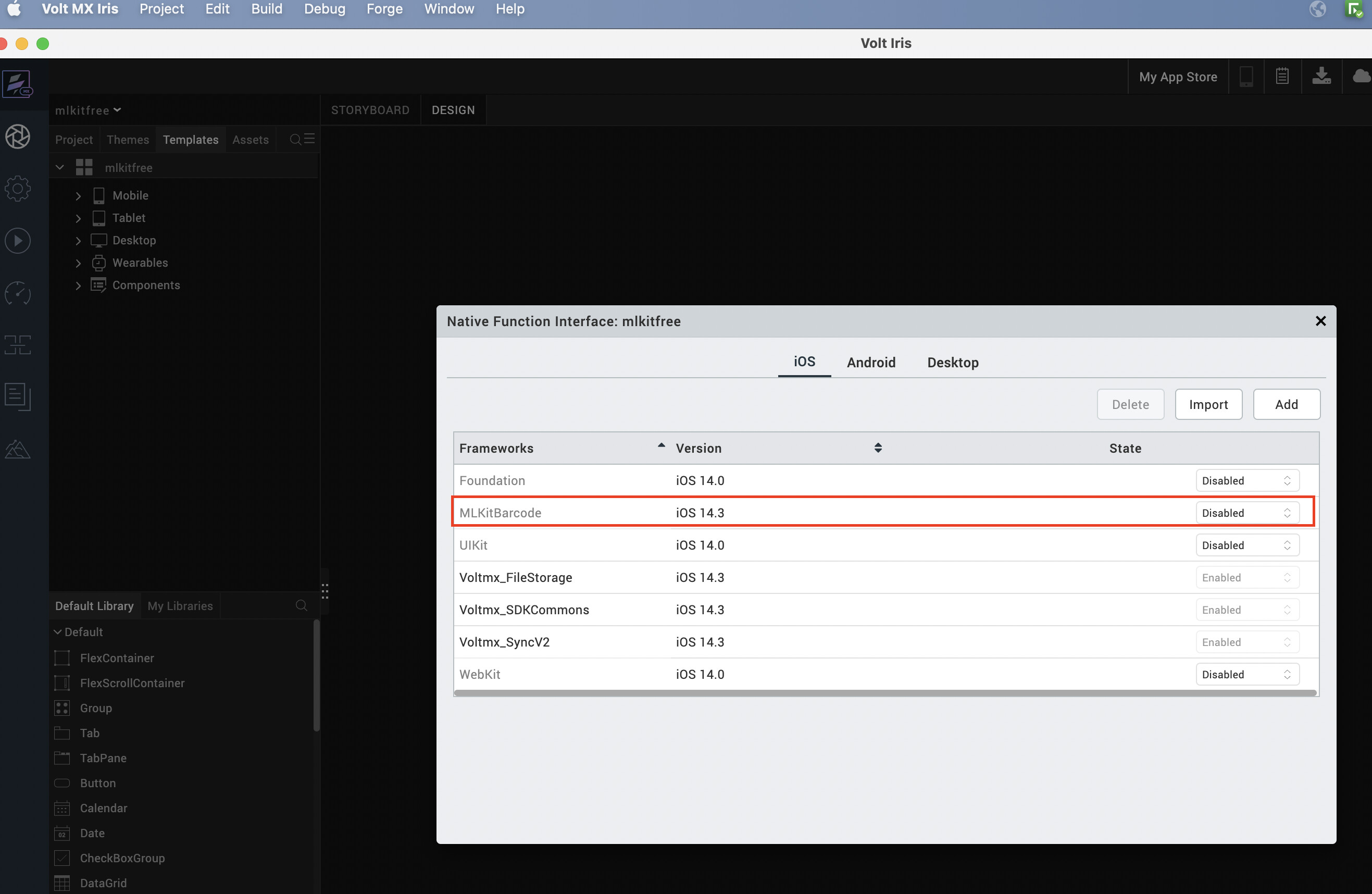

Hi Divyansha,
To test the app in simulator, we need to disable NFI responsible for MLKitBarcode as FBLPromise architecture is not supporting.
To do so, (in Iris) go to Edit -> Manage Native Function API(s) - > Disable the MLKitBarcode NFI.
Now, you build and test your application for simulator.

Thanks for answering, you made my day.
