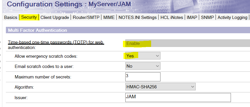

2) Enable TOTP in the Server Configuration document.

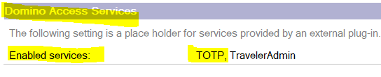

3) In the server document / Internet site document enable the below settings.
Internet Protocol -> Domino Web Engine -> Domino Access Services -> Enabled Services -> TOTP

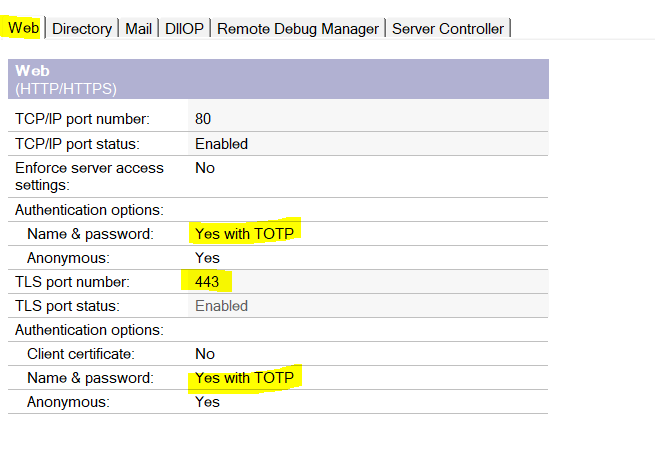

Ports->Internet Ports ->Web -> Name & Password set as "Yes with TOTP" as shown below.

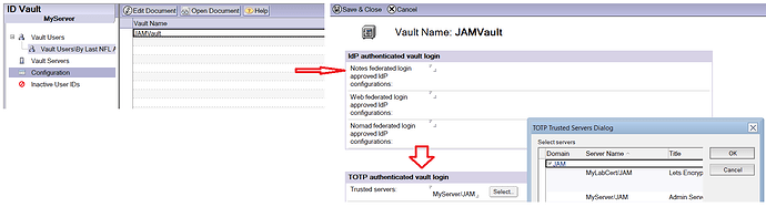

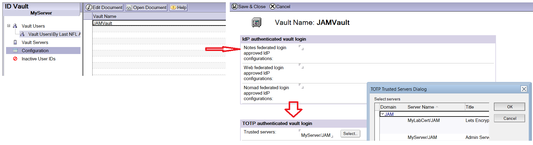

5) In the ID vault servers database open the configuration and then add the all the TOTP authenticated trust servers.

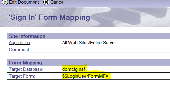

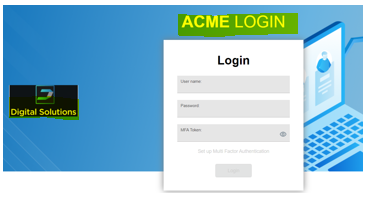

6) In the domcfg choose the login form as "$$LoginUserFormMFA". If you need to have customization to this form you can have it.
7) After these changes restart the Http task ( Restart Task HTTP). When you login you should see a login page as below. Below login page shows and text and logo has been added.

We already have customized domcfg.nsf with $$loginUserForm our company logo page with html, we have to create a new domcfg?
ANS: Yes, TOTP works with the new design with new Login form from domcfg V12 server. You need to upgraded the existing database with the new template and carry out the customization to the new login form ($$LoginUserFormMFA).
