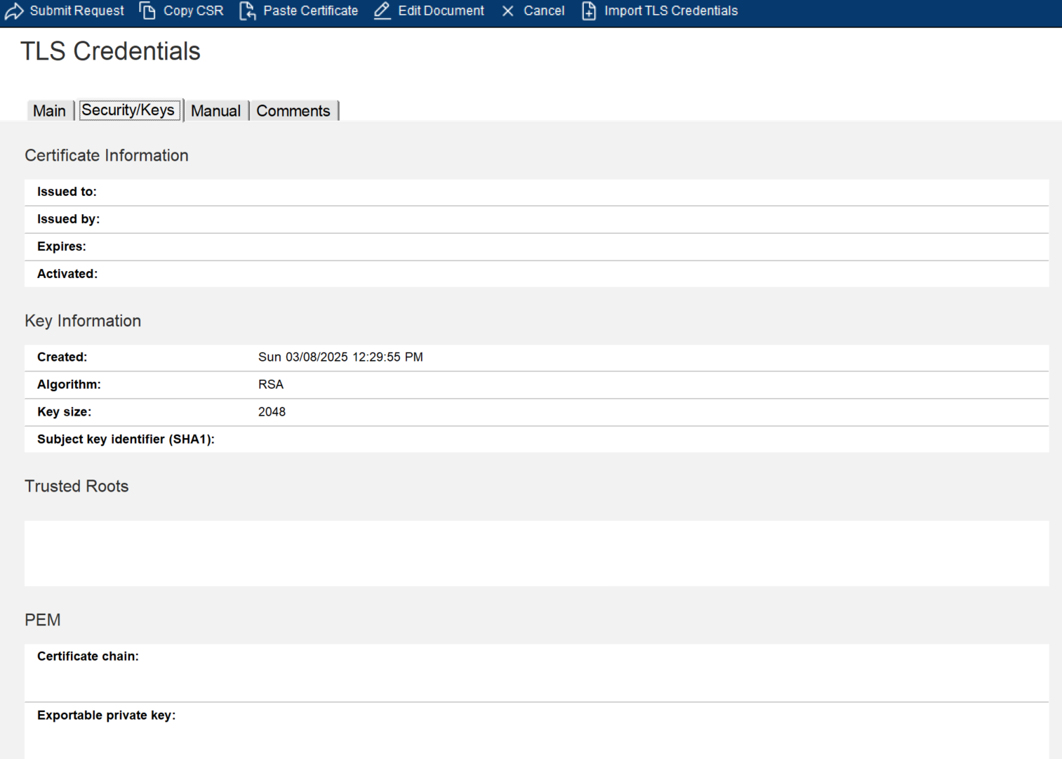

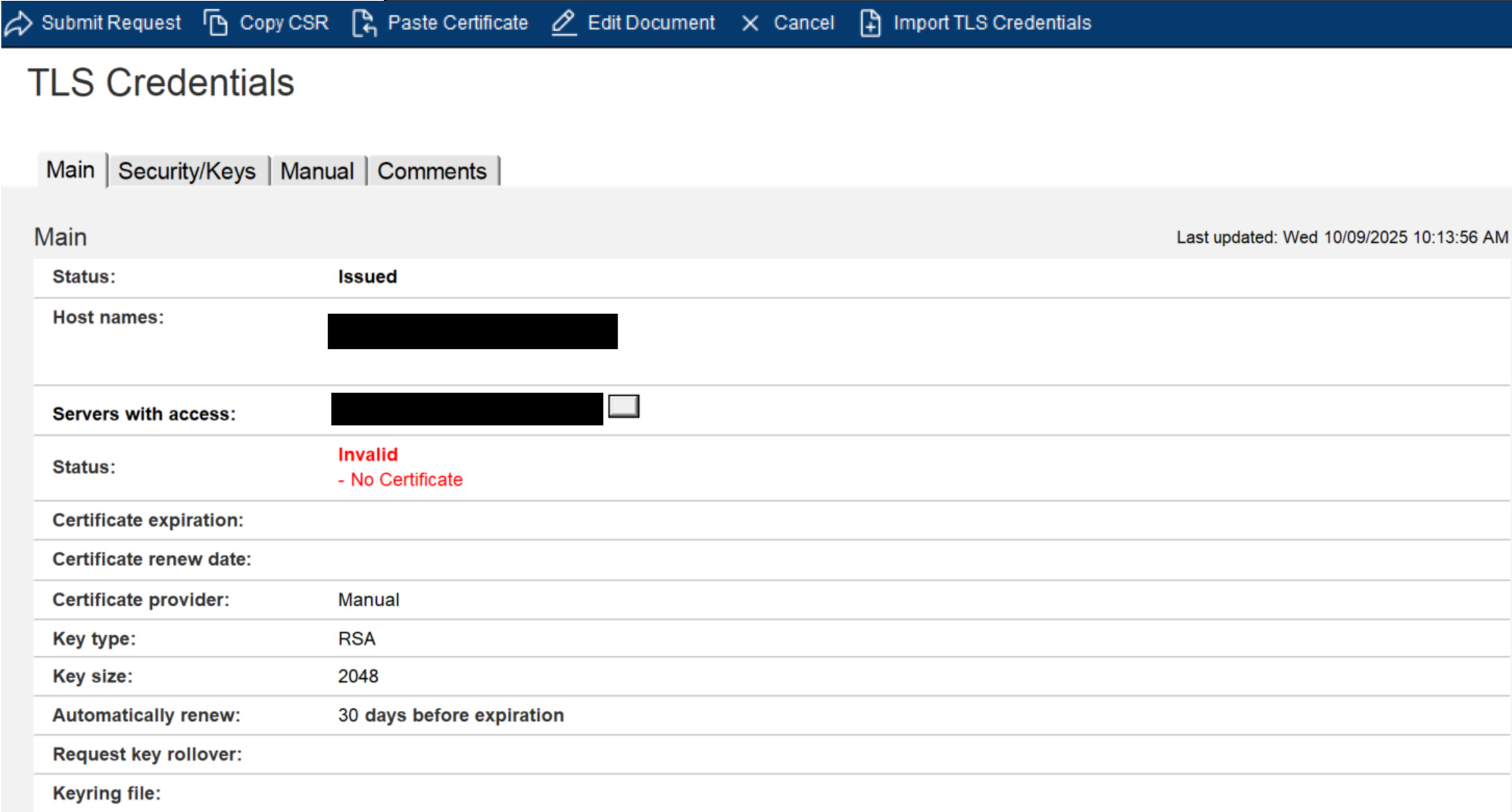

Hi Andrew, can you share the screen shot of the TLS document with error displayed also screen shot of the "Security/Keys" tab.
You can mask the information which is not required. Also let me know if there is a HCL support case opened we can work on it, as we may require to collect data

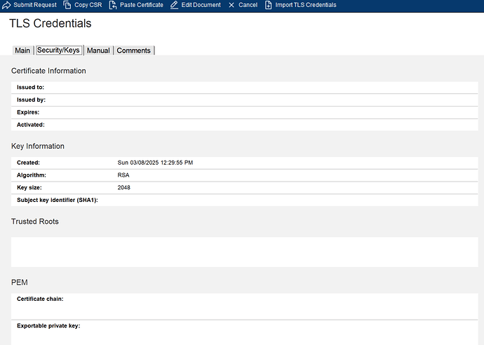

Hi @Shrikant
I’m back. Sorry to leave previously without answering you. Evidently I got distracted, but the problem then turned out to be that I had requested a 4096-bit certificate, but what I got back was based on a 2048-bit root. When I re-requested a 2048-bit certificate all was well.
But now…
The Domino server name (although not the hostname) has changed, so we need to start again. Learning from last time, I requested a 2048-bit certificate, which I have now received.
On pasting in the PEM and submitting it to Certmgr, I get the same message as before: “No Certificate”,
Here are the screenshots you requested earlier:
