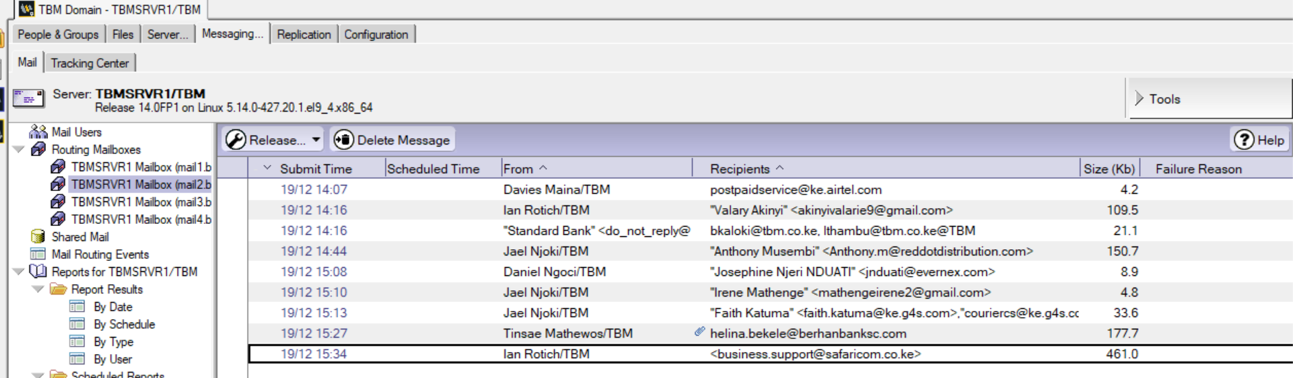

I am having an issue with Mails being relayed to destination server. The mails are currently being held on the Routing Mail boxes as show below
Could the issue be on my on my Routing on the Server .

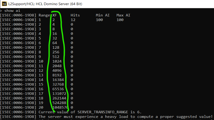

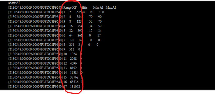

Looking at the screen shot it shows 4 mail.boxes so I believe the server may have not restarted in the above period. Can you check the status by issuing the below commands on the server.

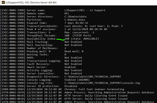

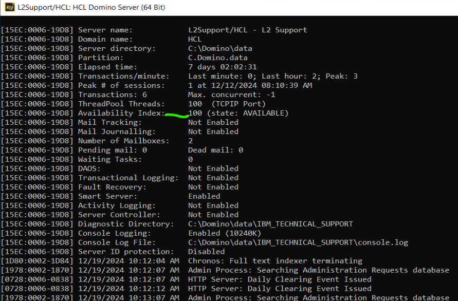

Show Server
The output should show Availability Index 100 or less than 100 but not "0"

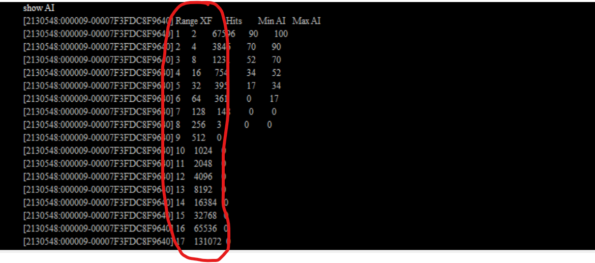

Show AI
The output should show XF column values with some numbers and not "0"

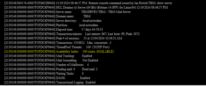

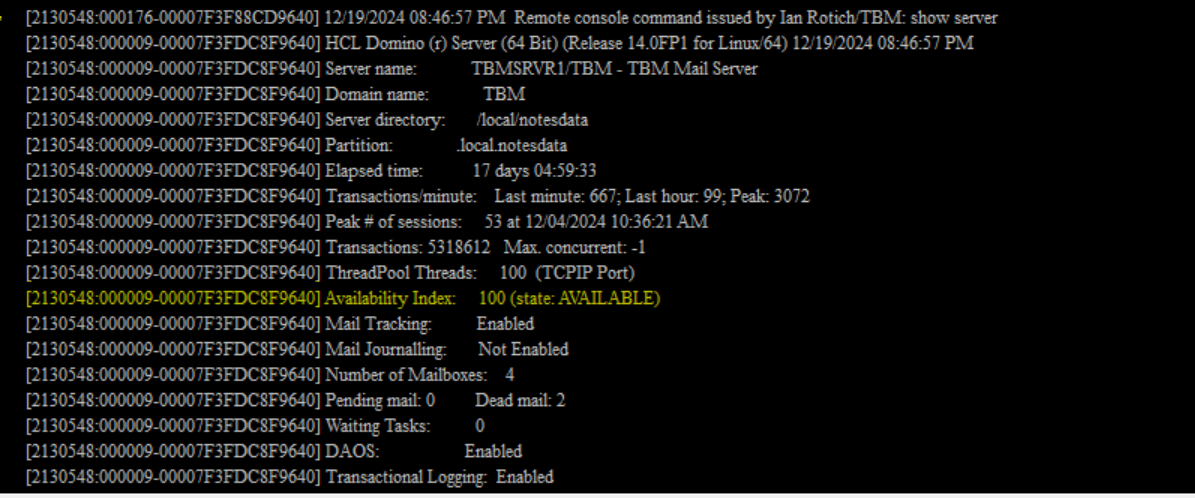

I have not restarted the server after the 13th of December.I am getting below results from Show server and Show AI
Show Server
Availability Index is 100
Show AI
Looks good and you are not affected by the critical routing issue as per the KB0118192. However, if you restart the Domino server then your routing will be affected and you have to install the FP3 + IF2 on Domino 14.0 (14.0 FP3 IF2). So it is recommended to apply the fix on the Domino server.
For current routing issue you can check the mail.boxes and see how long those mail are sitting the mail.box.
