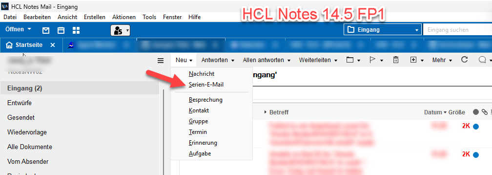

since HCL Notes 14 we can use Mail Merge in Emails.
In Notes 14.5 FP1 it shows Mail Merge in Mailfiles with Mail14 or Mail 14.5 Mailtemplate.

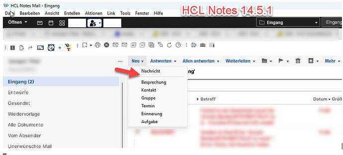

in Notes 14.5.1 Mail MErge is not shown on same Databases with Mail14 or Mail 14.5 Mailtemplate
Is there a bug or is something needed to configure?

So maybe you are using the wrong theme in your 14.5.1 environment so that that button is visible… Please check notes.ini entry “CURRENT_THEME_ID”. If it is not “com.ibm.v11.theme“ or “com.hcl.v14.theme“ then the button will be hidden.
in notes.ini is $CURRENT_THEME_ID=com.hcl.v14.theme,
I removed the $ in front of the setting, now it works.
I don’t know from where the $ came.
Thank you Tode
@Environment can only read variables that have a $ in front of it (non system variables), so the $ was correct. It seams for me, that the entry in your notes.ini was correct. But if it works now, then something else was wrong with that entry. Glad to be able to help

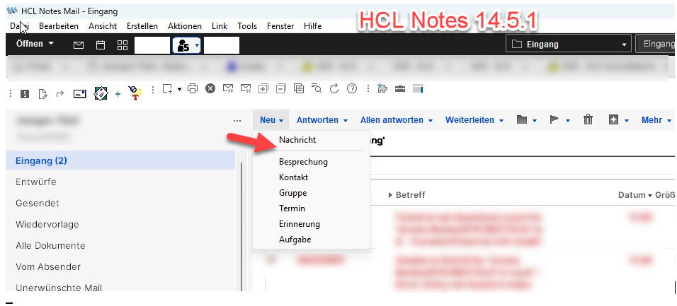

I wasn’t actually aware that New menu showed Mail from Stationary as an option.
I upgraded recently to 14.5.1, using Admin / Designer / Notes client installer.
I checked it thanks to your post and I noticed I don’t have it, but I do have a Mail Merge option which I see you don’t have.
I checked my notes.ini and noticed $CURRENT_THEME_ID=com.hcl.v14.theme
I tried removing the $, launched the notes client again, and my menu looks the same as with the $:
Mail Template: 14.5.1 English
Not sure if I’m missing anything.
Best,
Elvis
Hi Elvis,
it’s strange. Today stationary isn’t shown. Today removing the $ made no differenz- Maybe yesterday I looked at my wrong client, not sure.
I have to investigate again.

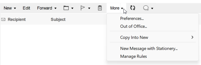

It is important to know: The shown option does not have anything to do with “Stationary”. New Mail from stationary is a different menu point
We are talking about the mail merge button as shown in screenshot. And I posted the Hide-When-Formulas for these buttons. If this formula is True, then the button is not shown.
