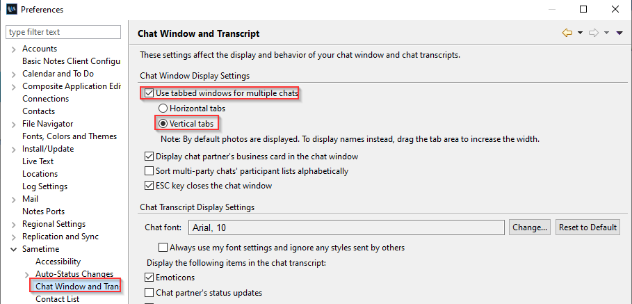

Hey Stefano,
try setting the following options:
This has worked for us very well.
You can roll out these settings via managed-settings.xml.

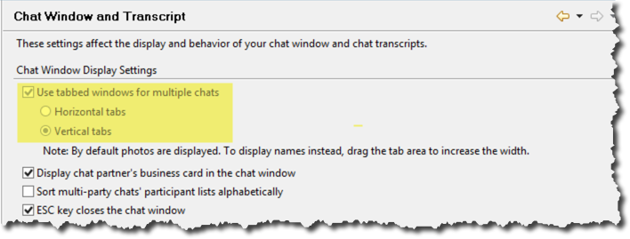

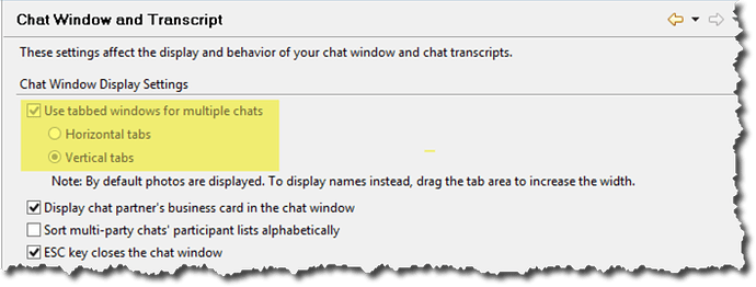

Thanks Milan, already done and forced through Sametime policy:
but id does not work.

  2. If vertical tabs option is selected, what are the results?

  2. vertical tabs are already selected: I also tried to switch to horizontal and then to vertical again without success (at the beginning I had also tried to force vertical tabs to test users through managed-settings.xml)
