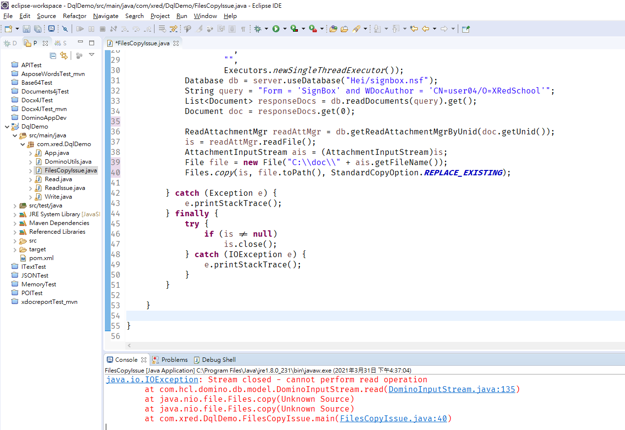

I have code below that is trying to copy a file from attachment.
ReadAttachmentMgr readAttMgr = db.getReadAttachmentMgrByUnid(doc.getUnid());
InputStream is = readAttMgr.readFile();
AttachmentInputStream ais = (AttachmentInputStream)is;
File file = new File("C:\\doc\\" + ais.getFileName());
Files.copy(is, file.toPath(), StandardCopyOption.REPLACE_EXISTING);
The file is copied successfully but I got this error:
java.io.IOException: Stream closed - cannot perform read operation
	at com.hcl.domino.db.model.DominoInputStream.read(DominoInputStream.java:135)
	at java.nio.file.Files.copy(Unknown Source)
	at com.xred.DqlDemo.FilesCopyIssue.main(FilesCopyIssue.java:40)
Is there something wrong? How can I fix it?
Any help would be greatly appreciated.
Thanks!
if(is != null) {
