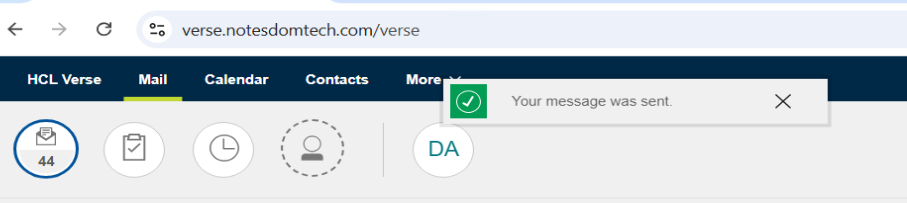

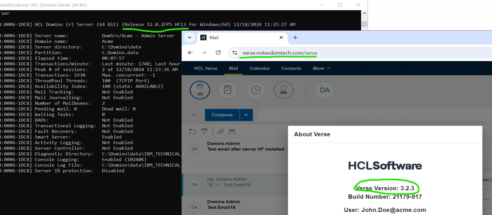

Hi Elvis,
I am running Domino 1202FP5HF13 and I don't seen an issue too.
When I reply any emails it just goes fine without an issue.
Is this an issue for all user or specific user ?
Thank you
Regards
Shrikant J
