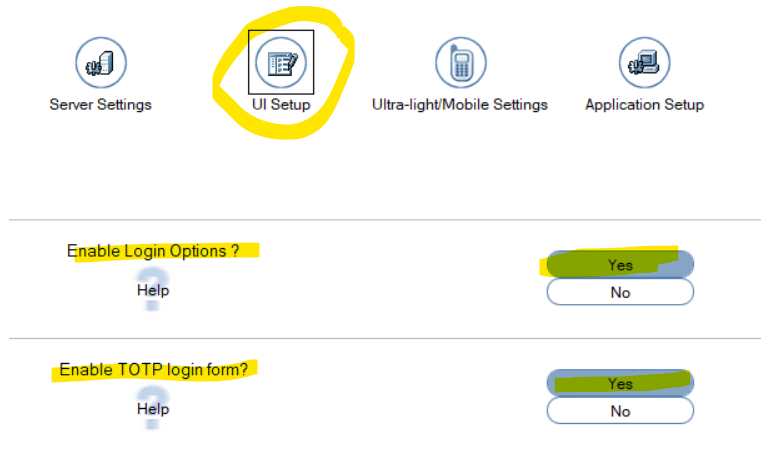

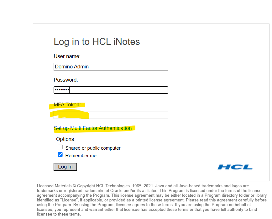

MFA option is indeed present in the DWALoginForm within the redirect template iwaredir.ntf as it is an inbuilt functionality of the database and you don't have to customize it.
You need to enable below option in the iNotes redirect database under UI Setup as shown below.

Yes, I followed this method to implement TOTP in the iNotes login form using the iwaredir.nsf database.
Thank you for the detailed information! I appreciate the clarification that the MFA option is already present in the DWALoginForm within the iwaredir.ntf template and does not require customization. I will proceed with enabling the option in the iNotes redirect database under UI Setup as instructed.
