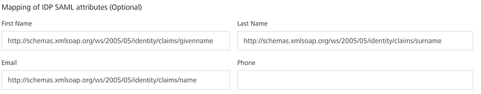

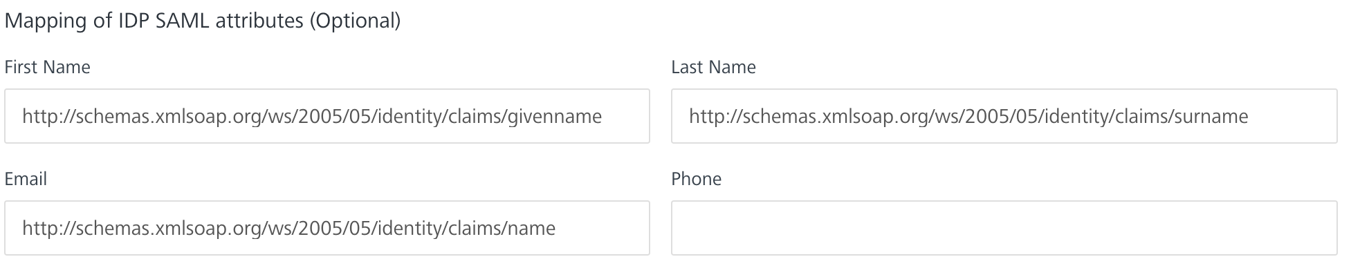

When using a SAML Identity Provider in Volt MX Foundry, you will see that only FirstName, LastName, Email and Phone No fields can be mapped from the console.
