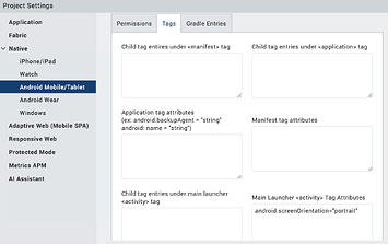

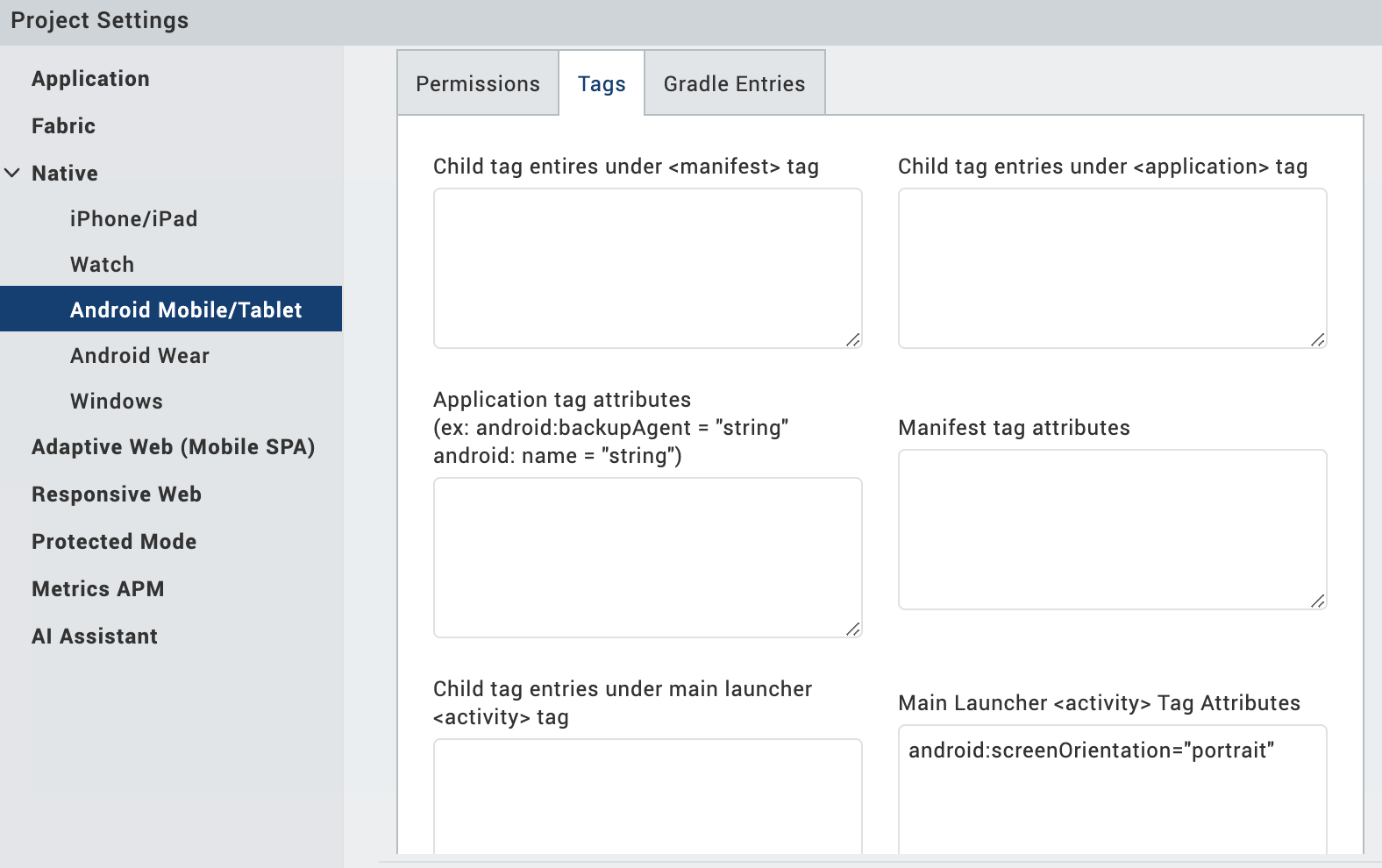

1) Add an entry in Iris project settings, as shown below.
