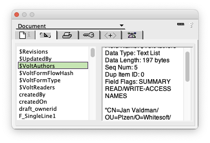

once you assign an user to a role in a Volt app, then there is a Domino ACL entry created for that person on the corresponding NSF file. The person receives and Author access level with create (and delete) permissions. The access to a particular document (a submitted form in Volt) is further controlled by $VoltAuthors and $VoltReaders which are managed internally by Volt.

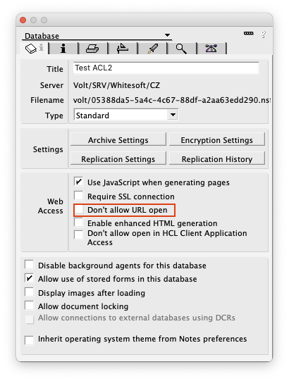

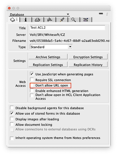

The remedy is quite simple, you have to disable URL open feature:
Then you might want to do the same on VoltApp.ntf in order to enable this setting for all new Volt apps.

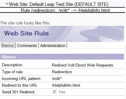

Now, if you want to prevent someone accessing deployed Volt application content directly using the Domino URL command syntax, you can. Just create a web site rule.
I tested this by creating a Web Site "Redirection" rule. For the "Incoming URL Pattern" I used "/volt/*" and I redirected to "/HelpfulInformation.html" which I created in the /data/domino/html/ directory and put a paragraph of text in explaining why you couldn't use that url syntax.
You can be specific about which volt applications this applies to as well, but being more specific with the "Incoming URL Pattern". For example, you can create a redirection rule specifying "/volt/4e5b65ce-004d-4099-8c95-a7e5dd860cbf.nsf/*" to redirect requests only to that database. You could have as many of these rules as you want, and each could point to a different alternative URL if you are so inclined.
