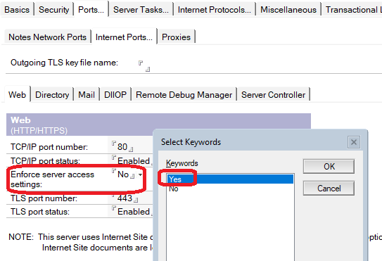

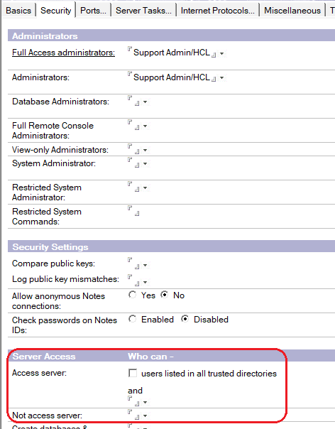

Hello @Rob Kirkland
Another option for access control for web users, if you set "Yes" at "Enforce server access settings".
The "Access server" and "Not Access server" settings are enabled for Web users.
