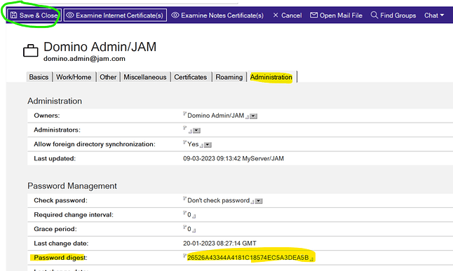

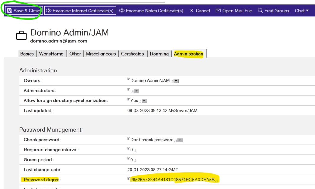

3) Now got to the People view, open the Administrator account person document.
4) Double click to put the document in Edit mode.
5) Go to the Administration tab and then clear the "Password digest" field (keep this field blank).
6) Save and close the document.
7) On the server console you can issue the below console command.
load updall -t ($Users) names.nsf -R
8) You should now switch back to the Administrator account on the Notes/Administrator client and server access should be allowed now.
