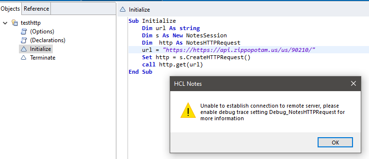

Hi Joe,
Based on the code you shared, may you please share what is the value of url variable?
My guess the starting value of the url variable is "https://" as well. If so, concatenating it in the hard code using ("https://" & url$) will result to -> https://https://.......
I tried to simulate, and I reproduced it:
If that's the case, you need remove the hard code, and use v = webreq.Get(url$) only.
Hope this helps.
Thanks,
Jayve
