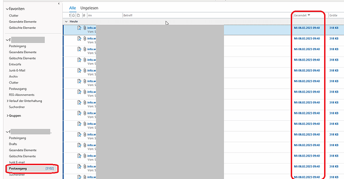

on a number of occasions (different users) new mails created in Outlook for sending via HTMO (v3.0.4) have become stuck in Outlook's outgoing mail folder not just once but many thousands of times within a couple of minutes. Thankfully, these emails do not get sent although in one instance a few did escape. I had another occurrence of the problem this morning - see screenshot - involving 5000+ copies of an email.

One or more "different" emails getting stuck in the outbox could be related to a Traveler sync issue (the sync request is failing). However, in this case, the scenario is a single email being rapidly (and excessively) duplicated in the outbox. That scenario is not related to the Traveler server version and not indicative of a mail server issue. Traveler NEVER syncs mail TO the Outbox on the client. I know you don't really care about this detail. I just wanted to clarify that this is unlike, for example, an explosion of "drafts" which is what Jesse is referring to. Upgrading Traveler will have no effect on what you are seeing.
I've looked back in the internal bug history for HTMO and, although I find a several references to a similar condition, it appears to be an elusive condition to isolate and fix. Most changes have been around trying to prevent the sending of these duplicates. On the Traveler server side, it does have a mechanism to try to prevent duplicate sends of the exact same content. Regardless, this still doesn't get to your question which is what you can do to resolve this. Apart from recreating your profile, I believe Outlook allows you delete mails in the outbox. Not sure how practical that is given the large # (see https://support.microsoft.com/en-us/office/video-send-or-delete-an-email-stuck-in-your-outbox-26d5d34a-4e5f-444a-a9e8-44db04a94dec)

On each occasion that I've seen this issue, it has been possible to simply highlight and delete all the messages in the outbox. The recipients have been different each time and have been a mixture of internal and external addresses.
