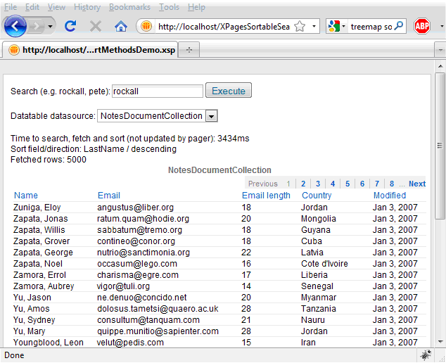

Subject: Another solution
See this blog post: http://www.bleedyellow.com/blogs/m.leusink/entry/xpages_sort_the_results_of_a_full_text_query_server_side_and_by_any_column_corrected1?lang=en
