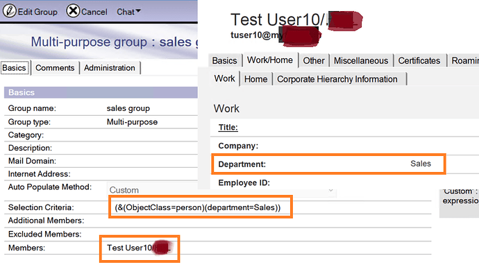

But you may try a workaround. Take any field(or a new one) in the person document and update the user’s OU there. Then create an LDAP filter for the auto-populated group.
For ex : Use the field “Department“ and set the same value in the OU, say “Sales“[User1/Sales/Acme]. Now use the filter like “(&(ObjectClass=person)(department=Sales))“
