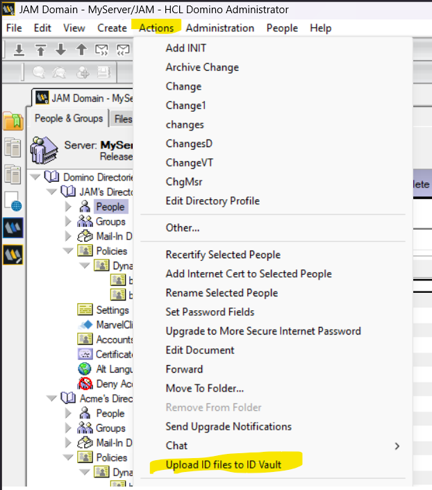

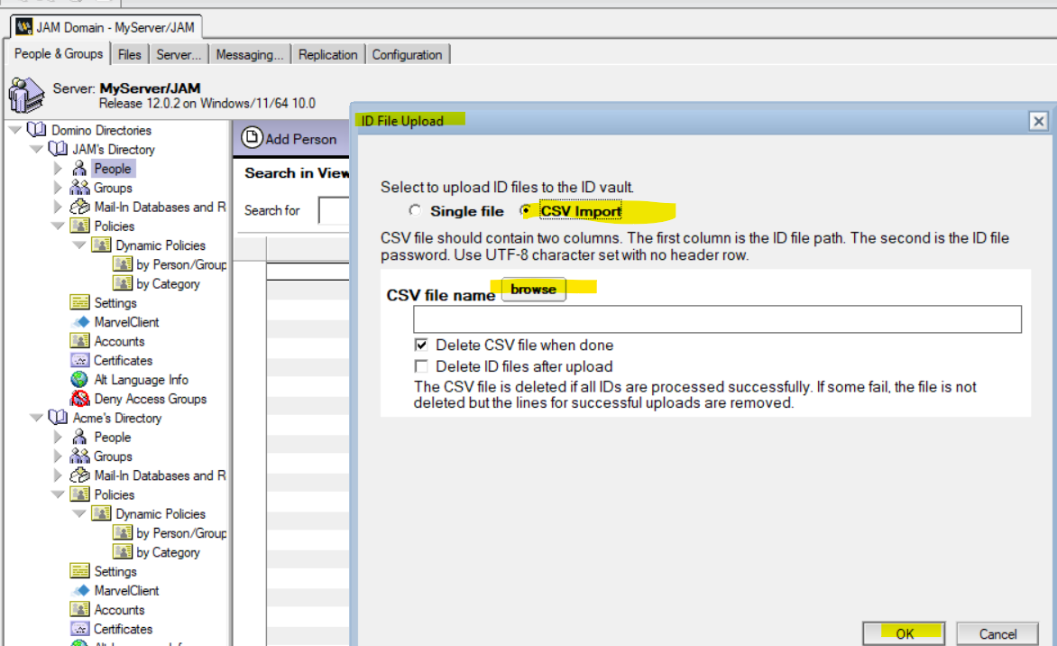

Other possible workaround may be from the existing Vault database you can extract the ID files to a location and then upload the ID files to the new vault database using the below feature on Domino 12.0.x.
**Extracting of the ID files from vault database is a manual process for each user.
Link:
https://help.hcl-software.com/domino/12.0.0/admin/conf_uploadingmultipleidwithcsv.html
