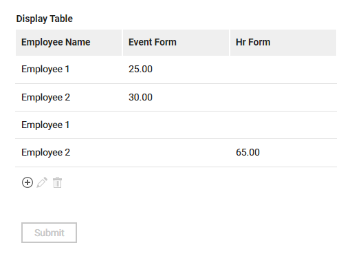

I am trying to learn how to merge and there is an example on the wiki but it is just very complicated I will attempt it again on the weekend as have learned significantly more. I have attached a picture of what I am trying to accomplish. I have two tables table A has unique code for each person and the person will appear only once in that table I have table B that has also that persons code but the name can appear multiple times but can appear only once in a year.

Not exactly that will just create extra rows of duplicate information like the output below following your procedure I am trying to achieve is that second row of employee 1 to merge with first row of employee 1 and employee 2 to have 30 and 65 in the same row. I am surprised that this is not a feature yet to make worthwhile applications you are going to have many cases like this
