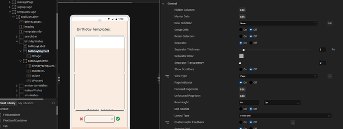

I have a segment (of page view type), and it only has the bImage element. I am populating the segment and the end results are shown below. A user can manually swipe between various segment data. But, I am unable to replicate the same behaviour via the code.
Assume there are 3 images in the segment. So, I have to programmatically change from image 1 to image 3. How can I do that? (I do not want to repopulate the data). I just need to change the swap the segment's image 2 and move the page view to the other image.

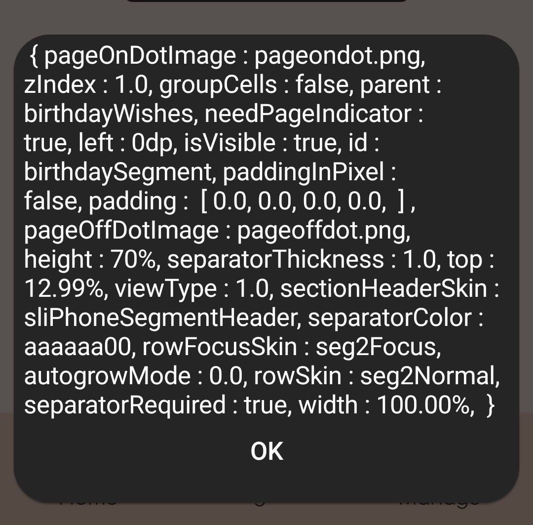

@Gunndarr Dotter it's not working for me. I am attaching the screenshots for your reference.
I am using this code in the form init function:
this.view.birthdayTemplates.onSelection = (e) => {
      alert(this.view.birthdaySegment);
Output:
birthdayTemplates is a list box component. I am just printing out the birthday segment details when selecting a new list component. There is no variable in the output through which I can see the current image/data being displayed in the segment.
