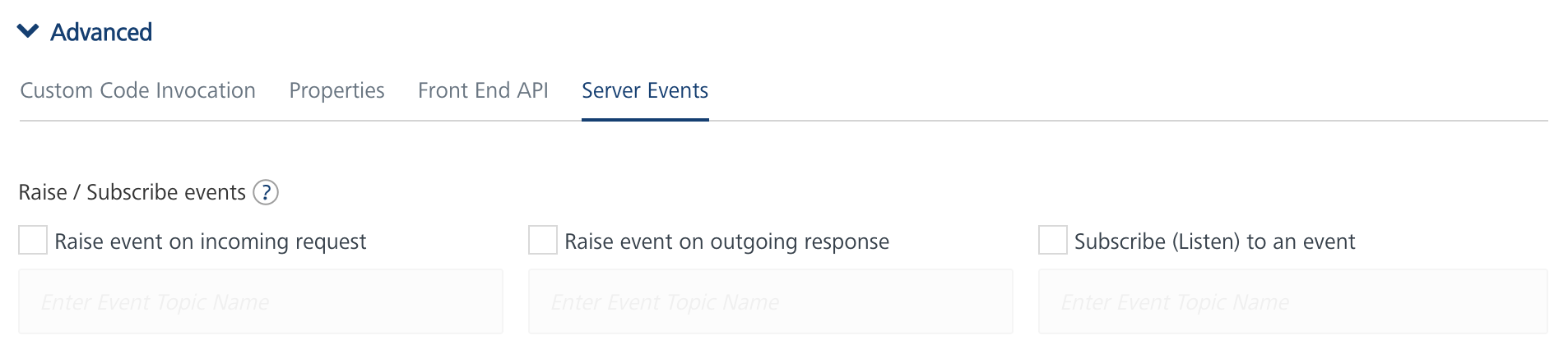

  2. Raise an Event based on the criteria suitable to your requirements, from Server Events tab of the Operation (as shown below).
  3. Use this Event to trigger your workflow.
