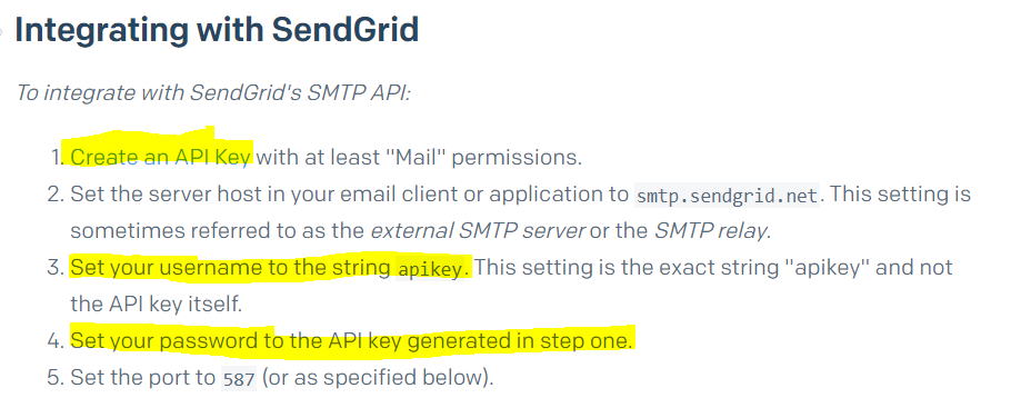

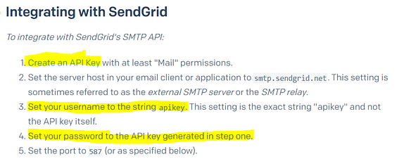

Hello David,
Reading the below SendGrid document.
https://sendgrid.com/docs/for-developers/sending-email/integrating-with-the-smtp-api/
It states that you need to generate a password using API key generator and once that is is done.
You can set the username for authentication to relay emails as "apikey" and password as generated from API key generator.
As an example of how these steps are done.
https://support.cloudways.com/how-to-configure-sendgrid-smtp/
Please contact SendGrid they should be able to help on this requirement. Thank you.
