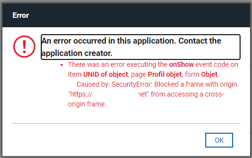

So here is what I wrote
const queryString = window.parent.location.search
const urlParams = new URLSearchParams(queryString);
var showcat = urlParams.get('UNID');
here is what I get
Am I right in assuming that this error could come from the fact that the website dev environment is on the other side of the continent and so not on the same server as the VOLT server ?
Yes, the hostname of the main window and the iframe should be the same to access the main window with that code. If you can control the allow-origin headers from the page inside the iframe then it could be doable though
Ok, I'll thenput this on the backburner until both are un the same server. As for allow-origin, let's just say that this is above my paygrade of citizen JS developer !!
