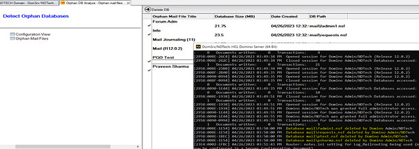

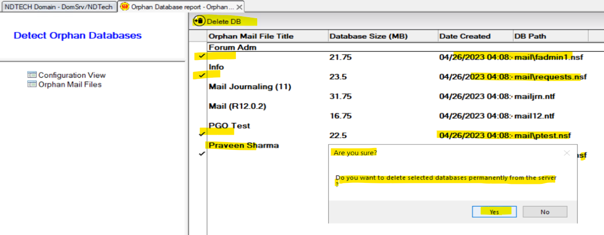

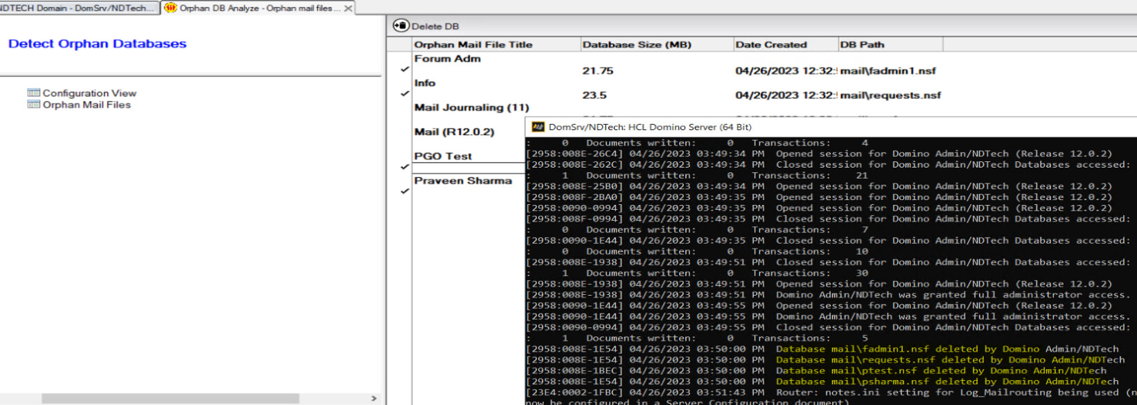

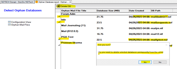

Tool screen shot.
When you choose "Yes" it deletes the selected database on the server as shown below.
It is always recommended test the tool test environment first before you perform on the production. To configure the tool refer the openntf zip file which has a word document how to configure it. You might also need full access administration rights on the Domino server to delete the database on the server.

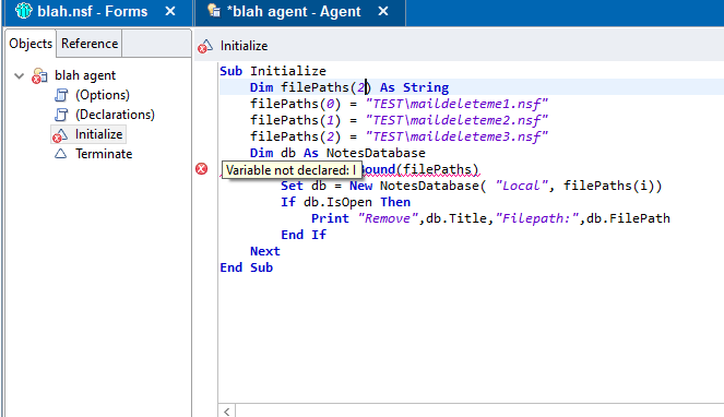

I understand that this is a very basic question and that I am not here to be taught LotusScript but I feel this is very close to being able to work but I get a "variable not declared" for "i" in this test script taken from @Torsten Link above.

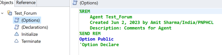

Hi Dave,
You should declare the variable "i" that you are using in your code. That's why the error appears.
Place one more line of code like -->
Dim db as NotesDatabase
Dim i as Integer
After this declaration, you can give a reference of "i" anywhere in the subsequent code.
Please refer to the below URL for more explanation of the error.
Variable not declared: <name>
There is one more way to skip the above error.
You can still avoid to declare "i" in your code and instead remove/comment line "Option Declare" as shown below:
Similar information is mentioned in the URL provided above.
However, I would recommend not to go by this approach. Declare all the variables that you are using in your code.
Regards,
Amit
Amit is absolutely right: Dim i as Integer is missing. I modified my answer to contain that line, so that it is "complete" for somebody stumbling about this later.
