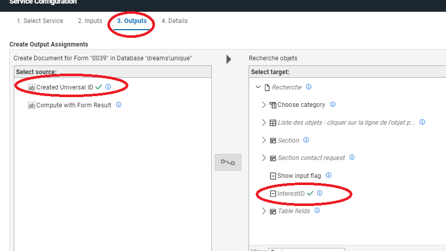

You could use the following services sequence to solve this
1) you create a document in the Notes DB, and the service gives ou back the UNID of the created Notes document.
2) you run the agent, giving it the UNID of the created document and the agent puts whatever values you need into this document
3) you then call up the service to read a specific document (you've got the UNID) and get the values you wanted.
This is just a successive use of standard services and ought to work.
You'd need to create an ID field where the created ID has to be stored. As soon as you need to start the procedure run the document creation service (1), it then gets the value. In onItemChange, you then run the agent (2) followed by the service to call up the created document (3) and et the values you need.
Hope this is understandable and helps.

In the Output section of the service to create a document, you can map the UNID of the created document to a field

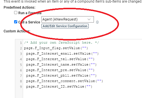

In the onItemChange event of the field 'receiving' the UNID of the created document, you can call up a service - in my case it was to run an agent
But it could be a service to read a document based on the UNID and populate some fields.
