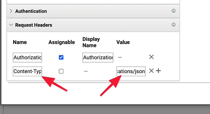

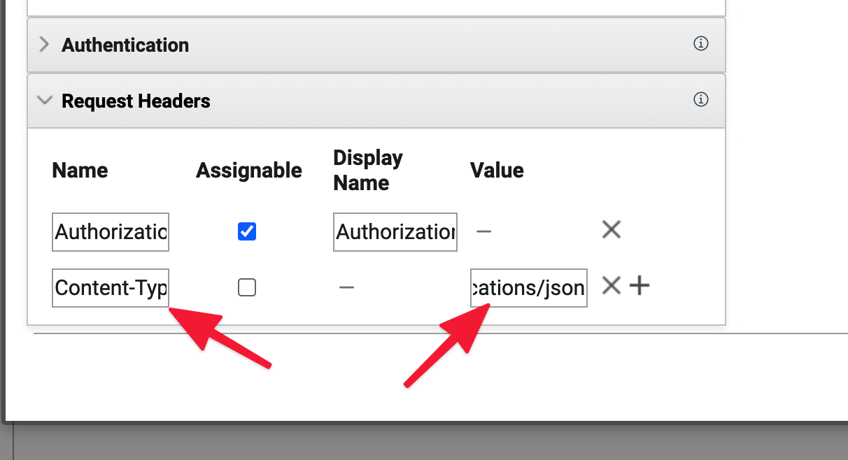

As for the unsupported media type, may need to know more about what the REST service is doing. That message means it's returning data in a format not known to the server (i.e. JSON, XML). You may need to set the Content-Type header in the service call (see image) so it knows what is being sent and what is being returned. You should be able to see this in the REST test client request and response depending on if it's a GET or POST
We've added the Content-type header that was missed in our first attempt. The error is a different one now.
