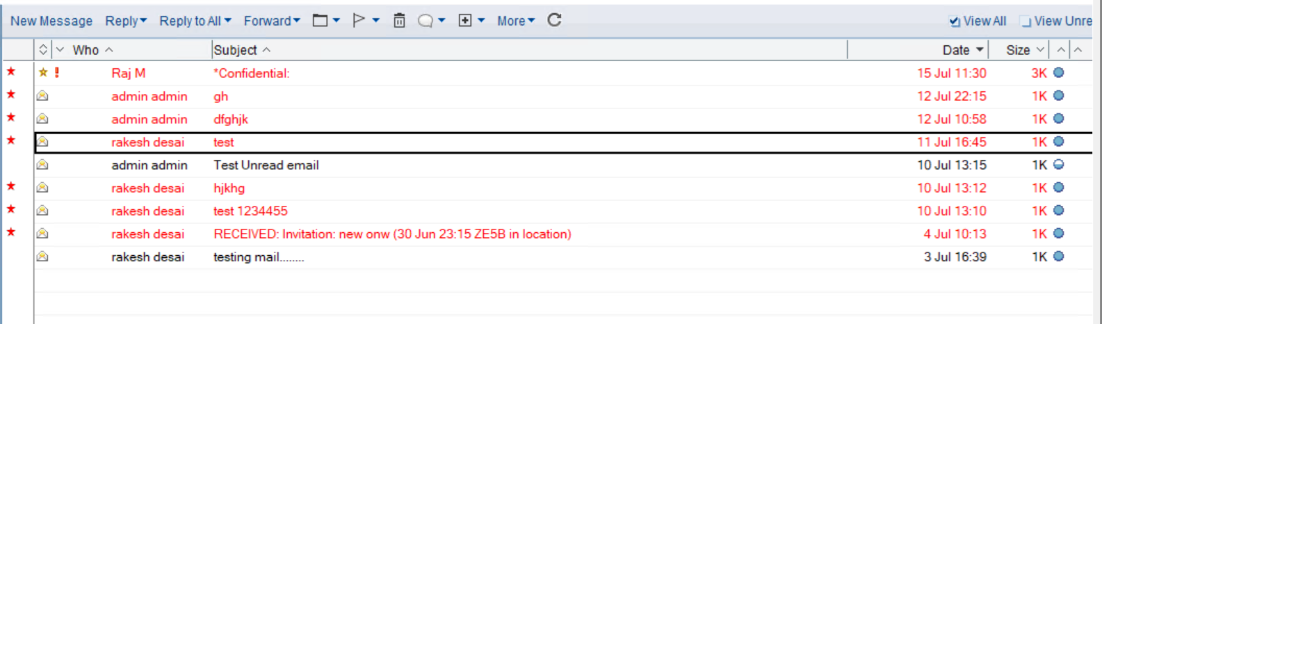

I Got my answer thanks for this. I have one more query , I want to know unread emails for this i used STATUS error = NIFReadEntries(
hViewCollection, // collection handle
&IndexPos, // where to start
NAVIGATE_NEXT, // skip direction
dwSkipCount, // number to skip
NAVIGATE_NEXT, // return direction
dwFillCount, // number to read
READ_MASK_NOTEID + READ_MASK_INDEXANYUNREAD, // data to return (or add READ_MASK_SUMMARY)
&hBuffer, // output buffer
&wSummarySize, // buffer size (optional)
&dwEntriesSkipped, // skipped count
&dwEntriesReturned, // returned count
&wSignalFlags // signal flags (optional)
); but not getting it. could help me on this how to extract unread status ?

I think you have a separate forum post here that is similar to this recent query:
I believe you need to go loop through the dwEntriesReturned in order for you to check the status of each returned NoteID if it has unread or read marks.
