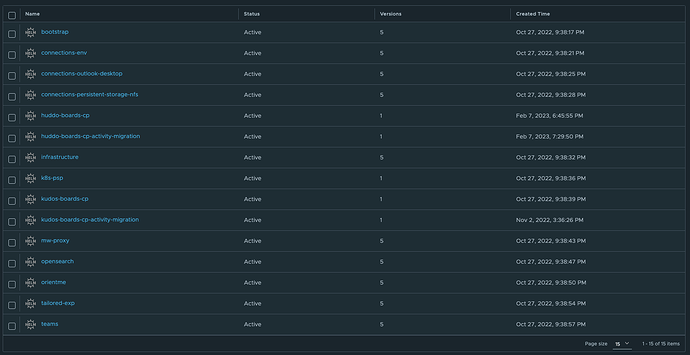

I tried to update Component Pack for Connections 8 from CR4 to CR6 and recognized that there a no Helm charts from this year in Harbor:
I suspect they were deleted somehow. ;) When will the Helm charts be restored?

Hey Marius,
I can't see them in the GUI, too.
Just try getting them via command line, that should work as documented.

Thank you @Christoph Stoettner ! I found the latest Helm charts. But that means this documentation is wrong / outdated:
https://opensource.hcltechsw.com/connections-doc/v8-cr6/admin/install/cp_install_services_tasks.html
If you do a:
helm show all v-connections-helm/infrastructure --devel | grep "^version:"
You get:
0.1.0-20231006-050011
That's the outdated Helm Chart from the charts view in HCL Harbor.
