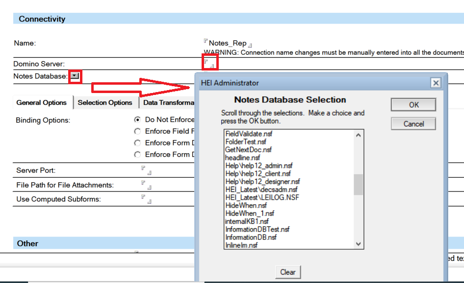

Sorry, I screwed up on my typing.
Lets say the Domino Server is "Server A" and this server has HEI installed.

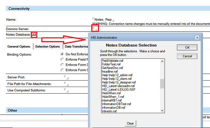

Wouldn't the job using the Connection access "Server A" if the Domino Server field is blank? Basically the "Local" server is the Domino Server (Server A) when HEI runs the Job.

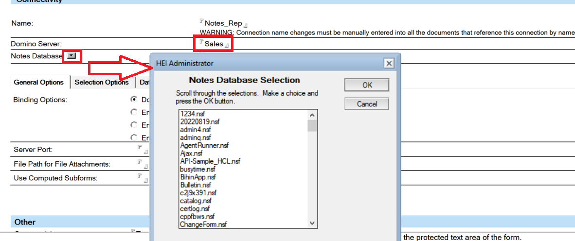

No, you have to explicitly mention the server name "Server A" in your case if you want that to be involved. If you don't specify this server, how will you populate the "Notes Database" field?
"Local" doesn't mean your Domino server has HEI installed. "Local" means nsf present on your local machine (that is in your NOTES DATA DIRECTORY).
You can try that in your environment by passing the Server name or keeping it blank. See what list is getting displayed for "Notes Database" field in both scenarios.
Refer to the screenshot shared with you earlier.

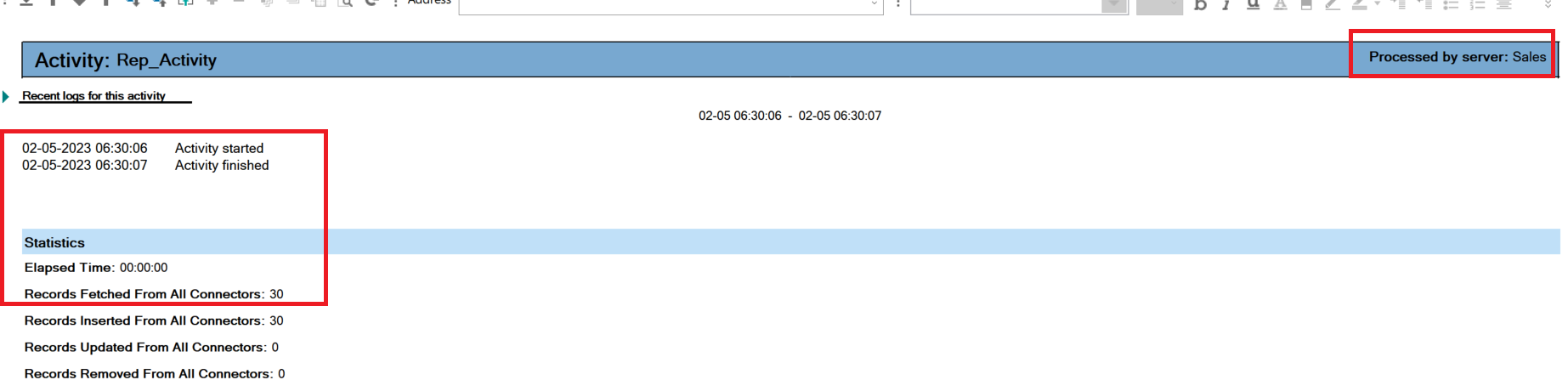

The testing results i have shared have Domino Server "Sales" on top which HEI is installed.

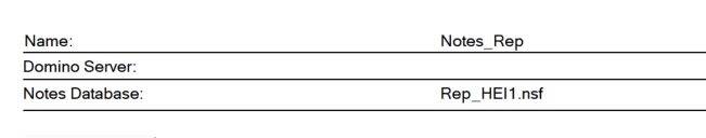

Connection Doc -->
Replication Activity referring to this Connection Doc -->
