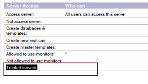

A possible workaround could be to put the HEI server name in the Trusted server field of the Application server hosting the problematic agent.
Open Application server document--->security tab--->Trusted servers---->Add the HEI server name --->Save the Application server document--->Restart domino server.
Now check the issue and confirm.
IF the above approach fails please provide the error screenshot for further assistance.
