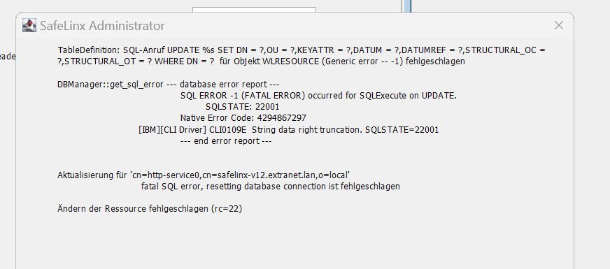

Hello Hubertus,
Looking at the screenshot, the issue observed when adding/updating any of the SafeLinx service via Administrator.
To get more details, can you please share us the recent contents of /var/adm/wgmgrd.log file ?
Hello Hubertus,

Hello,
Thank you for the reply.
Do you have access to DB2 database, if so, can you execute below command and see how SafeLinx working after this change ?
CONNECT TO WGDATA;
ALTER TABLE WG.WLRESOURCE ALTER COLUMN DATUM SET DATA TYPE VARCHAR(7999);
Our purpose is to update the DATUM column size to maximum supported (currently we kept as 7999). Even if my command fails, can you try to update the DATUM column size in WLRESOURCE table in WGDATA database to 7999.
