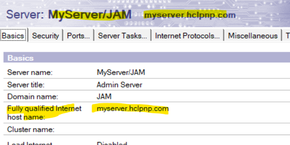

Hi Chris,
Some background about the error.
SMTP Protocol Returned a Transient Error:
The error, "SMTP Protocol Returned a Transient Error," indicates the failure to successfully transfer a message from a source SMTP server to a destination SMTP server is considered of temporary duration, such as: DNS, firewall or destination site limitations. Resend attempts will be made for up to a default time interval of 24 hours.
For example:
"<MM/DD/YYYY> 05:37:42 PM Router: No messages transferred to ACME.COM
(host ritz.ACME.COM) via SMTP: SMTP Protocol Returned a Transient Error"
Transient errors are often associated with a 4XX error code, such as:
"421 ritz.ACME.COM SMTP service not available, closing transmission channel"
To understand more on how the SMTP transaction is happening to external domains, enable the below debug on the Domino server.
Set Config SMTPClientDebug=1
Tell Router update config
Tell SMTP update Config
Example of debug traces as below.
[3C8C:000C-5918] 23-03-2023 08:08:30 [3C8C:000C-5918] SMTPClient: Attempting to Connect: Host DOMINO.PNPHCL.COM, Port 25, SSL Port 0, Connecting Domain myserver.hclpnp.com
[3C8C:000C-5918] 23-03-2023 08:08:30 [3C8C:000C-5918] SMTPClient: Connection successful
[3C8C:000C-5918] 23-03-2023 08:08:31 [3C8C:000C-5918] SMTPClient: ReceiveResponse: 220 DOMINO.PNPHCL.COM ESMTP (b47f5d159c0bc6219dd0c63be3622d2e)
[3C8C:000C-5918] 23-03-2023 08:08:31 [3C8C:000C-5918] SMTPClient: CommandEHLO: EHLO myserver.hclpnp.com[3C8C:000C-5918]
[3C8C:000C-5918] 23-03-2023 08:08:31 [3C8C:000C-5918] SMTPClient: ReceiveResponse: 250-DOMINO.PNPHCL.COM Hello myserver.hclpnp.com [10.28.69.10], pleased to meet you
[3C8C:000C-5918] 23-03-2023 08:08:31 [3C8C:000C-5918] SMTPClient: ReceiveResponse: 250-SIZE 100000000
[3C8C:000C-5918] 23-03-2023 08:08:31 [3C8C:000C-5918] SMTPClient: ReceiveResponse: 250-STARTTLS
[3C8C:000C-5918] 23-03-2023 08:08:31 [3C8C:000C-5918] SMTPClient: ReceiveResponse: 250-PIPELINING

It is something the recipient domain is not accepting the email from your domain it shows in the traces.. Where Domino has received a response saying "501 5.5.4 Invalid domain name"
[1C88:0010-2D14] 23/03/2023 07:52:28 [1C88:0010-2D14] SMTPClient: ReceiveResponse: 501 5.5.4 Invalid domain name [VE1EUR01FT078.eop-EUR01.prod.protection.outlook.com 2023-03-23T07:52:28.599Z 08DB2A074DF6D579]
[1C88:0010-2D14] 23/03/2023 07:52:28 [1C88:0010-2D14] SMTPClient: ReceiveResponse: 501 5.5.4 Invalid domain name [VE1EUR01FT082.eop-EUR01.prod.protection.outlook.com 2023-03-23T07:52:28.696Z 08DB2A0C842E2F3D]
[1C88:0010-2D14] 23/03/2023 07:52:28 [1C88:0010-2D14] SMTPClient: Attempting to Disconnect:
Can you check if your Domino server FQDN in the server document has valid entry for your domain example as below.
I see in the logs as "28v107w22/soteria-grid.boogledomino.com" which I believe is incorrect. You can change this to soteria-grid.boogledomino.com
After making the changes you can restart the Domino server and then try sending an email.
Thank you
Regards
Shrikant J
Domino server FQDN name can be changed to this as well "28v107w22.boogledomino.com"
As I can understand the Domino server name may be this 28v107w22/soteria-grid
Thank you
Regards
Shrikant J
thanks this worked!!!
we now have mail flow
