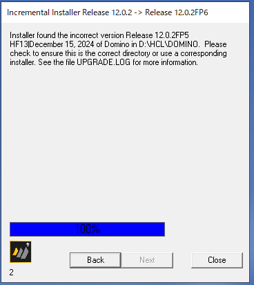

Hello,
To install FixPack on HF installed Domino server, You should uninstall the existing HF and then install the Fixpack.
If you don't uninstall the existing HF13, FP6 installation does not proceed with the message as on below screenshot.
