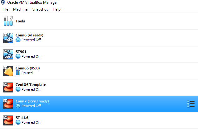

Hi Thomas,
I'd build several Connections environment on Linux inside Virtual Box on Windows 10. So far, they all ran fine.
However, like what Thorsten said, base on the performance of Virtual Box, it is not suggested to run Connections as a Production on it.
Simply test environment would be fine to run on Virtual Box.
And if you plan to deploy Connections Component Pack on Virtual Box as well, that may require more resource of your desktop PC.
My Laptop: 8 core, 32G memory.
I tried to deploy CP inside Connections 7, and the VM image stuck at starting page.
Then, I tried to install CP on another image, and ran both Connections 7 and CP image at the same time, the these two image cause my laptop had no response.
So, from my experience, either you have a clean windows(with no other software running on it, and 32GB memory may be enough to run both ConnX 7 and CP. But the performance would be ugly)
Or you have a more powerful PC to run it would be much better.
Hope my post can help you a little bit.
