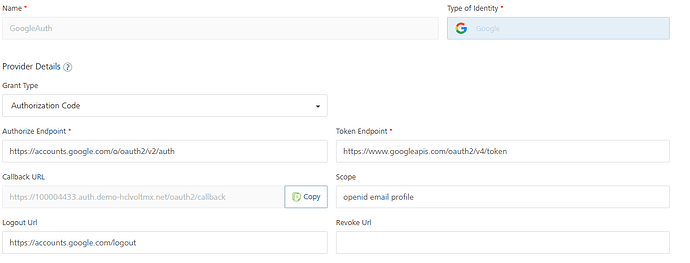

Print do setup do serviço de auth no foundry:

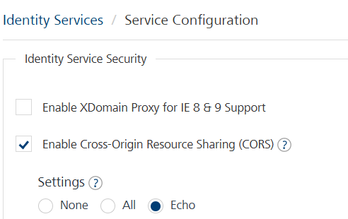

Can you please navigate to below path and check what setting is enabled.
Open HCL Demo Account–>Api Management–>Apis–>identity–> Service Configuration–>Enable Cross-Origin Resource Sharing (CORS) whether this option is enabled?
Also please confirm whether you are trying to access this identity service from with in the domain or from external domain. If you are accessing this identity service from external domain then you need to enable this option and publish the app and then test the issue.
Perfect!
