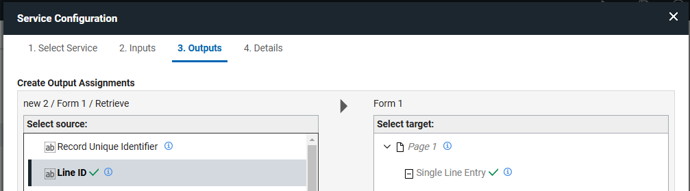

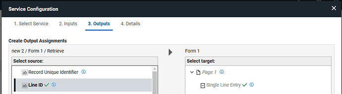

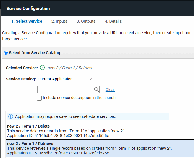

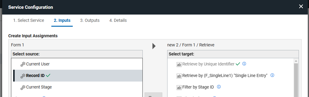

When the document loads, you could call a service that looks up the same document by UUID and returns the Line ID into a field that you can then use.

Hi Christopher,
can you provide the name of service to use and an example?
We don't want the UUID (as f904d907...) but an incremental numbers ID (as 1, 2, 3,...33,...) of the record.

Hi @Christopher Dawes
your solution is perfect.
Thank you very much!
