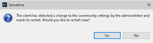

We recently upgraded to Sametime 11.6 on a Domino Server running 12.0.2. Since the upgrade, everytime we log into Sametime in our Notes Client, we get the following challenge...

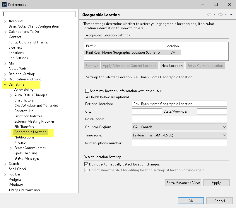

I always click "No". My Client Sametime Preferences are as follows...
I'm suspect that this issue is a result of the upgrade... if anyone knows how to address that challenge, I'd appreciate hearing from you.

Hi Paul,
The change detected popup message is because the version of Sametime client is installed with persistent chat disabled. Sametime 11.6 servers deploy with persistent chat enabled as a policy. On initial client startup, the server will push down the persistent chat enabled policy requiring a client restart to fully enable. Note: In later versions of Sametime client, persistent chat is enabled on install to avoid the change detection message needing a restart.
If the message continues, it suggests the server is failing to support persistent chat and the client is disabling it to ensure chat at a minimum is functional. The server will continue to push the policy to enable persistent chat which can cause the client to get into a loop of enabling/disabling persistent chat.
Please open a support case and we can assist in reviewing the server and client configuration.
Concerning Geographic Location, is there a separate issue needing review?
