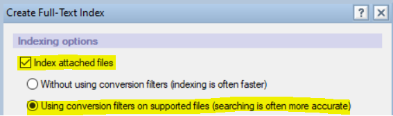

1. Try recreating index with following options enabled.

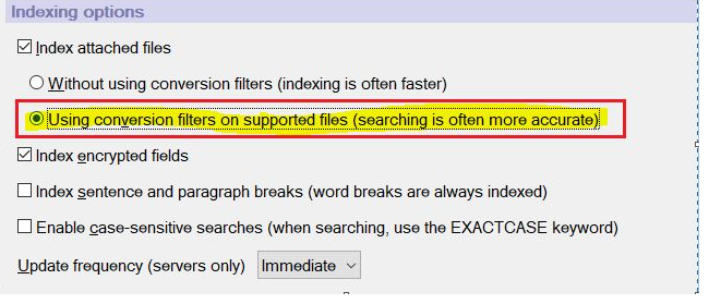

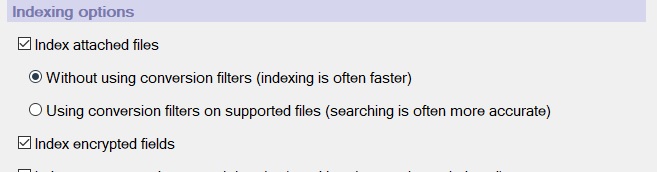

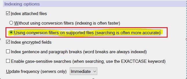

Hello @Stefanie Krueger ,
On the mentioned database, please check the options selected for full text. Please navigate to Database--> Properties -->Select Full text (Second last Tab( -- select update index and check if the below option is selected.
It Indexes all attachments without conversion filters. This method is fast but less reliable.
We kindly request you to select the second option, as shown in the screenshot below.
When conversion filters are used for attachment full-text indexing, the Domino server and Notes standard client use Apache Tika 2.4.1 open-source conversion filters to extract text for full-text searches of attachments.
Please refer below article for more information.
https://help.hcl-software.com/domino/12.0.2/admin/admn_attachment_indexing.html
Hence, please update or recreate the full-text index of the mentioned database using the above option and then check accordingly.

Many thanks for your information.
I don´t used the correct indexing options.
With this choice it´s working.
