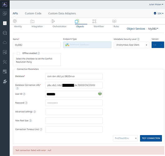

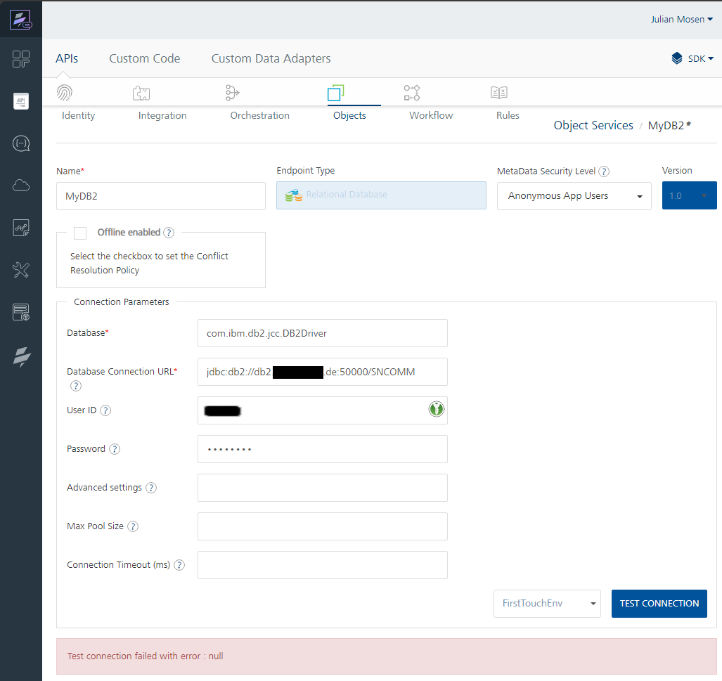

- I added the necessary Java library (db2jcc4.jar) to the middleware_home directory under <install-dir>/middleware_home/lib/database. Foundry accepts the driver and doesn't throw any errors on startup.
- I created a new object service (following screenshot) and referenced the JDBC driver class from my JAR. Database connection URL, user id and password are correct.
When I test the connection, Foundry prints "Test connection failed with error : null".
If I change anything in the object service configuration (e.g. provide wrong credentials or url) Foundry prints another error message, telling me that the URL is wrong. My DB2 database accepts connections from Foundry, I checked that, too. - I checked the server logs, such as catalina.out, but I can't see any error messages that help any further.
