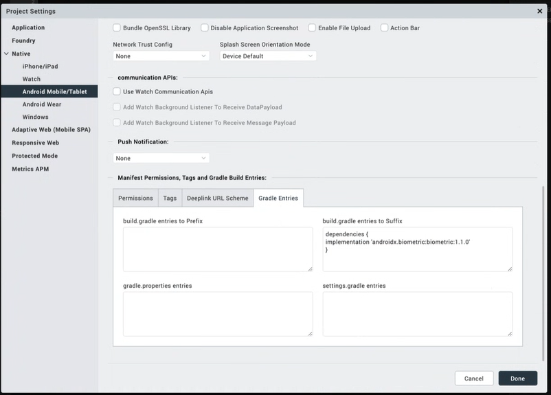

Thank you for reaching out to us. We came to know that there is currently an issue with the platform’s Gradle entries for biometric dependencies. At the moment, the platform is not automatically including the necessary dependency, so you will need to manually add it in the Project Settings under Gradle Entries to make it work.
Please refer to the image below for guidance on how to enter the dependency manually. We’re actively working on resolving this issue, and this will be addressed in the next Iris release. Until then, the manual entry is required.
dependencies {
implementation 'androidx.biometric:biometric:1.1.0'
This will ensure that the Fingerprint component functions correctly.
Additionally, we are in the process of updating the documentation for the Fingerprint component to reflect this workaround, ensuring users are informed about the necessary manual entries.
We appreciate your patience and understanding as we work on this fix.
If you have any further questions or need assistance, feel free to let us know!
