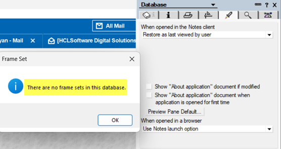

Thx for yours, but my DB/Properties/Launch tab does not allow me to uncheck the box for “Restore as last viewed by user”. I only have the option to select one choice.
You got the wrong “Restore as last viewed by user”. There is an option with the same name further down the dialog:
Thx for yours, but that setting appears to only be avaialable if the “Open designated Frameset = Borderframe“, which we do not use.

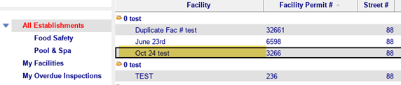

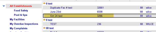

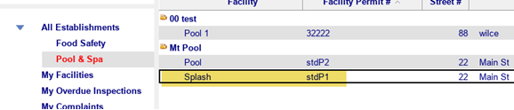

My problem is when the DB is open, after I change views and return to the original view. So I have a view open with a doc highlighted…
Then I go to another view…
Then I return to the original View. I want it to take me to the top row in that view… not the doc that I had been on previously
