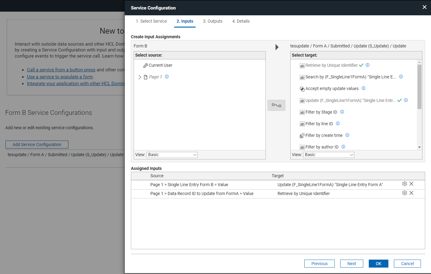

Hi Vici,
Please try this:

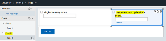

First off, you need to specify in the Form B what is Record ID you need to update in Form A to sync:
Then, update the Inputs tab in the service like this:

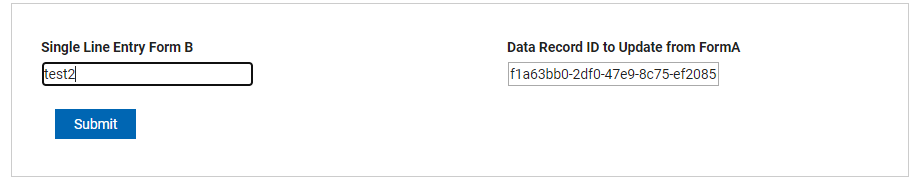

To test, for example, I have test value in single record of Form A:
Then, if I hit submit button in Form B, the output is:
Hope this helps.
Thanks,
Jayve
Crazy, I tried this way yesterday and it didn't work. Okay, what the heck, many thanks for your help, it's definitely working now :-)
You're most welcome Vici. Happy to help.
