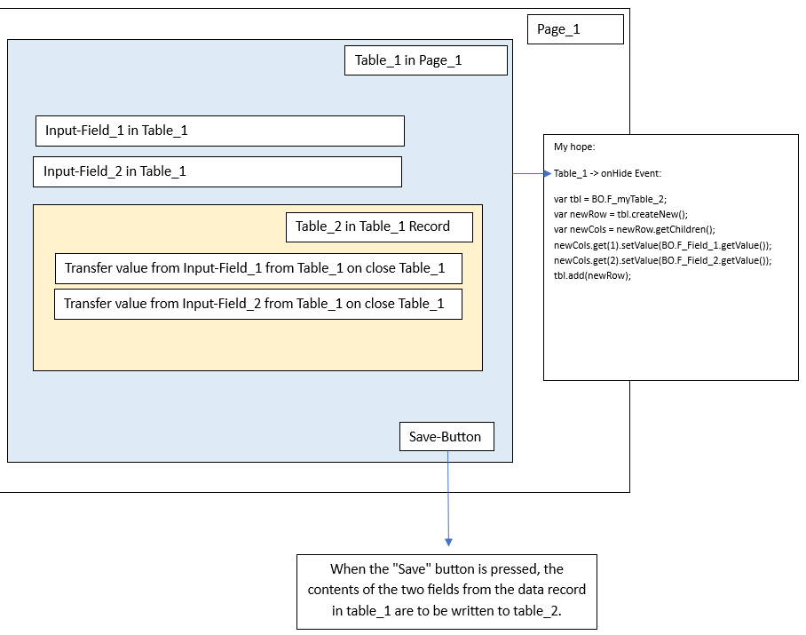

Hello Christopher, thank you very much for your reply.
I have packed my use case into a graphic. Pictures say more than words :-) Specifically, it is about transferring the content of two fields to a table (Table_2) when leaving the table (Table_1). Table_2 is located in Table_1. The onHide method would be well suited for this. I can of course take a diversion and check all other fields when changing each field (onChange) and generate the table entry in Table_2 from this when Table_1 is open. It's more work, but maybe it would be a solution.

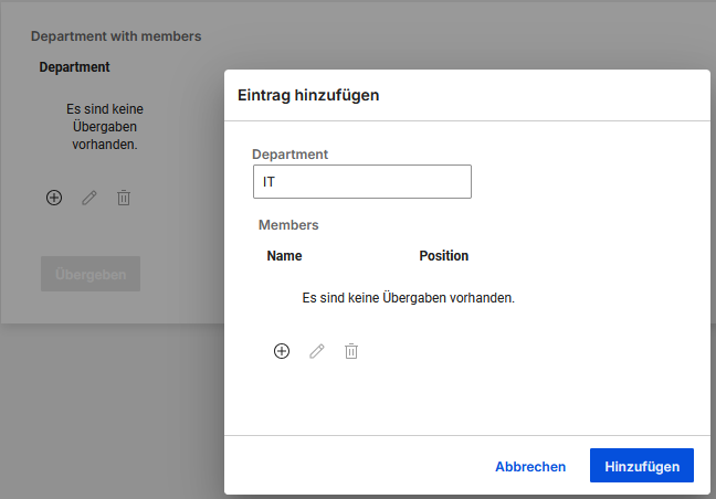

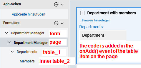

i created a small demonstration to demonstrate how to modify a the ‘inner table’ of a newly added row:
// onAdd() event Code for the "Department with members" element
// using itemBO you can access everything added to the table "Department with members"
// "itemBO.F_T_Members" returns the table object for the members table
// Note that the autocomplete will not suggest table items. either search for the ID by hand or with the 'ctrl + space' menu
let table = itemBO.F_T_Members;
let newRow = table.createNew(); // create a new Row for the "inner table"
// just to demonstrate with this code i will always add myself as Head of the department i added
newRow.F_Name.setValue(app.getCurrentUserDisplayName());
newRow.F_Position.setValue("Head of "+ itemBO.F_Department.getValue());
// add the newly craeted row to the "inner table"
table.add(newRow);

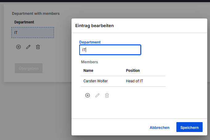

Before submitting the row:
After submitting the row and opening the entry again:
