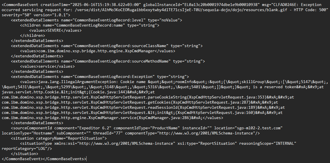

Hello, shigemitsu.tanaka
We have an addendum to this problem. We are as follows:
Please help, what is this error?
Thank you
Regards,
Katrine Chu

Old problem: XPage HTTP 500 Error when cookie from https://cookie-script.com is added - Customer Support
Workaround
1 - Create a properties file on the ‘xsp’ folder under Domino program directory named ‘bootstrap.properties’ and set the contents to:
xsp.commas.not.delimiters.in.cookie=true
2 - Restart http task
