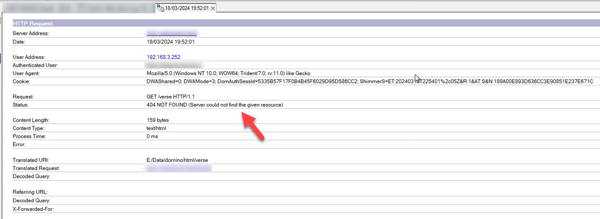

a "rare" error implementing VOP 3.2.0... following this procedure:
https://help.hcltechsw.com/verse_onprem/3.2/admin/vop_configuring_server.html
(this is not the first time I've installed verse for a client, but in this case I'm stuck)
my environment:
  • Domino 12.0.1 (windows) running ok
  • Use UTF-8 for output OK
  • inotes Running, including https, OK
  • IDVault implemented OK
  • INOTESDISABLEXPAGECMD not present in notes.ini
  • HTTPJVMMaxHeapSize=2048M ok
  • HTTPJVMMaxHeapSizeSet=1 ok
  • internet address set person document in NAB OK
  • VOP extracted in /DATA/domino/workspace/applications/eclipse/plugins/ OK

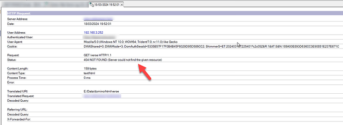

I restart the Domino, I access inotes without problems (with https), and when I put /verse in the url the server simply does not recognize the URL and gives a 404 error (I also see this in the domlog.nsf)
Any ideas ? I know it must be nonsense, but I can't find it!
Thanks
