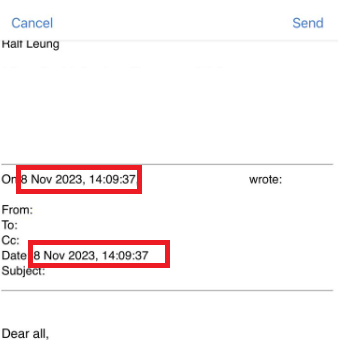

Now I am using iOS 17.1.1 and HCL Verse Build: 12.0.21.2023091821, when I forward / reply email, there have 2 symptoms:
1 - there are 2 "Date" as below (I removed all of the contents and remain the questioned items):
2 - once forward the email, some of the recipients will also display in the original email.

The reply/forward behavior of inserting the "On <current date/time> <author of mail being replied to/forward> is by design. Agreed that this is different than Verse Android. These are different code bases with different origin stories so not surprising that they don't always behave the same way. I do not consider this a bug.

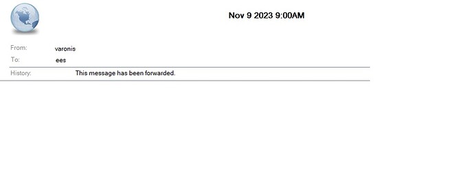

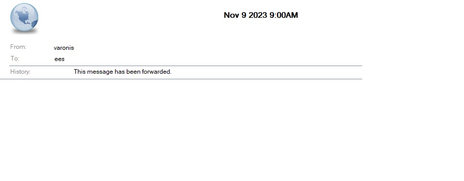

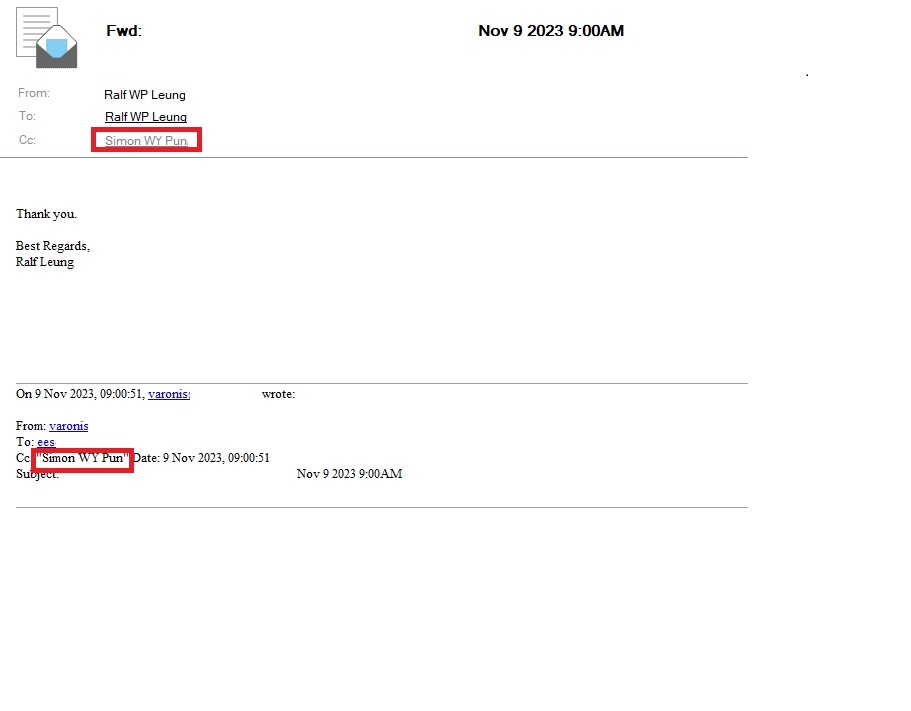

For #2, here is the sample, when I forward the email with Cc recipient, it will display in the original message
but there has only one recipient in the original email:
That will be confused by the recipient that why they did not receive the original email.

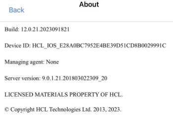

Here is my information when checking my Verse Mobile Client:
Is that the correct information you need? thank you for your comment.
However, it seems this problem is just occurred recently..
Ralf,
That is helpful. Your traveler server is a very old version: 9.0.1.21 which is more than 5 years old. This explains why we don't see this in the lab. With that traveler version, when you reply/forward, it is the client that is constructing the entire email. In later versions (starting with 12.0), the client is only constructing the reply or forward message and the server handles appending this to the original mail before it is sent on. This is what is called SmartForward/SmartReply.
