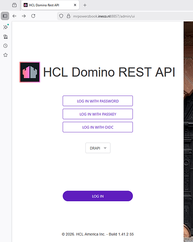

I can log in to native Domino with OIDC, for example when navigating to names.nsf.
On the Domino REST API page there is no new drowdown other than DRAPI.
When the page is loaded this is printed to the Domino console:
30-01-2026 21:13:34,27 [81B8:0066-7BC4] FindMatchingProvider> Match found
30-01-2026 21:13:34,27 [81B8:0066-7BC4] SECValidateAccessToken> JWT includes: email=, iss=HCL Project KEEP RANDOM, kid=, alg=HS256, sub=CN=MRPOWERZBOOK/O=INECO, auth_time=0, iat=1769804014, exp=1769811214
30-01-2026 21:13:34,27 [81B8:0066-7BC4] SECValidateAccessToken> JWT includes: upn=, at_hash=, scope=MAIL $DATA $DECRYPT $SETUP Domino.user.all, azp=, nonce=, acr=, aud.count=1, amr.count=0
30-01-2026 21:13:34,27 [81B8:0066-7BC4] SECValidateAccessToken> JWT includes: TypHeader=JWT, TypPayload=, clientId=, jti=, event=0, CN=CN=MRPOWERZBOOK/O=INECO, lsid=
30-01-2026 21:13:34,27 [81B8:0066-7BC4] SECValidateAccessToken> Cannot use a JWT lacking email or iss or kid or aud
30-01-2026 21:20:13,96 [85A4:000F-6FC0] SECCheckForOIDCUpdates> Entering with 1 providers in cache
30-01-2026 21:20:13,96 [85A4:000F-6FC0] SECCheckForOIDCUpdates> Provider https://auth.ineco.nl/auth/protocol/oidc; expiration 31-01-2026 21:19:06
30-01-2026 21:20:13,96 [85A4:000F-6FC0] SECCheckForOIDCUpdates> Last purged cache 30-01-2026 21:18:16; 117 sec since last purge; 43200 interval
When click on LOG IN WITH OIDC and LOGIN
“status” : 404,
“message” : “This is not the URL you seek!”,
“errorId” : 0
