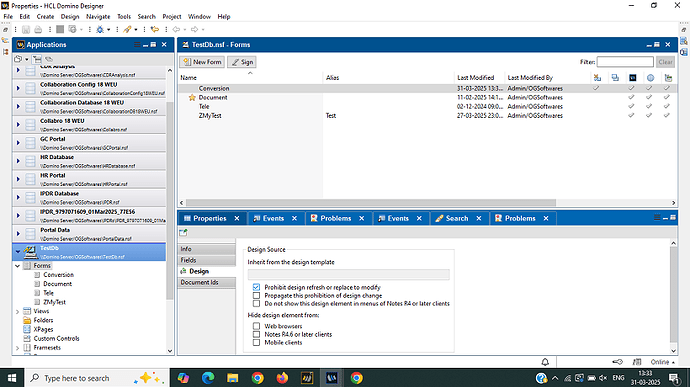

If for the particular design element , you have checked "Prohibit Design refresh to Replace or Modify", replace design will not change the locked elements. Have you done that besides Locking the design element.
please see screen shot below:
Hello @Rajneesh Sharma ,
thats right. That is a work around if there are only one or 2 productiv database of the template.
But you have to set this in the productiv DB, not the template db where you actually are developing. If there are more databases that inherit their design from this template you have to set this in all DBs as developer:
1. the right to change this in a productive design in each of these DB's concerned and
2. you have to keep track of all of them and don forget one to set ... and reset each element if done
Thats not really very effectiv and prone to subsequent errors , right ?
